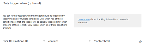

Assign an All Links Click trigger that fires only when the contact link is clicked. Define the trigger condition, for example,
Click Destination URLcontains/contact.html.
- Save the new tag and test the MTM container.

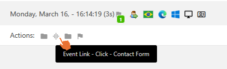

- Trigger the custom event (for example, clicking the contact link).
- Confirm that the event appears in both platforms.
