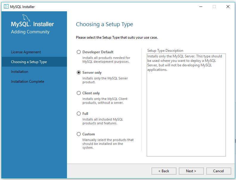

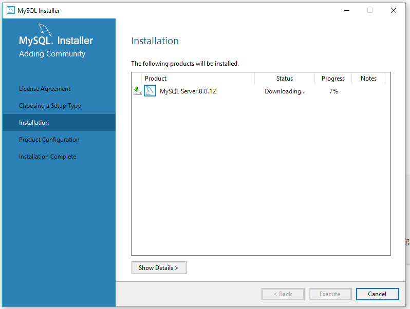

Select Server Only

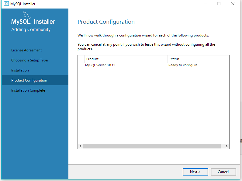

Select Execute
Select Next

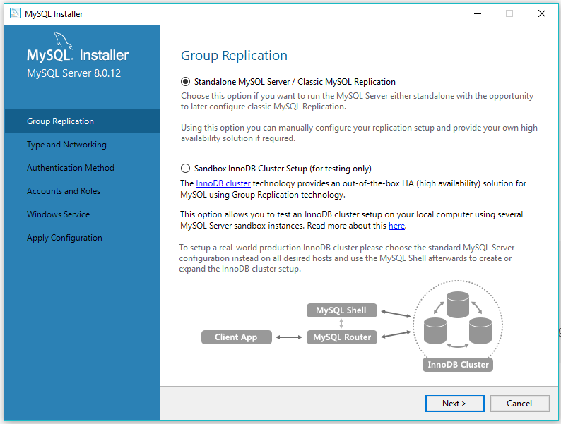

Select Standalone MySQL Server / Classic MySQL Replication then Next

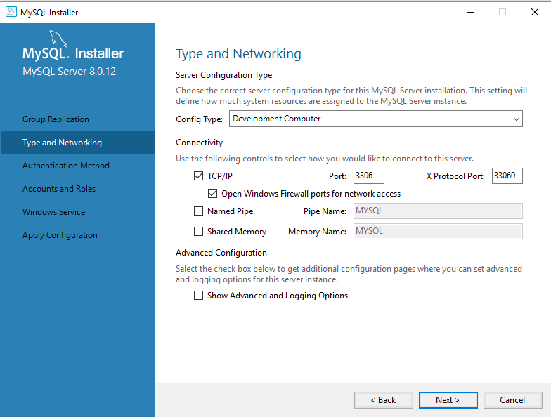

Click Next

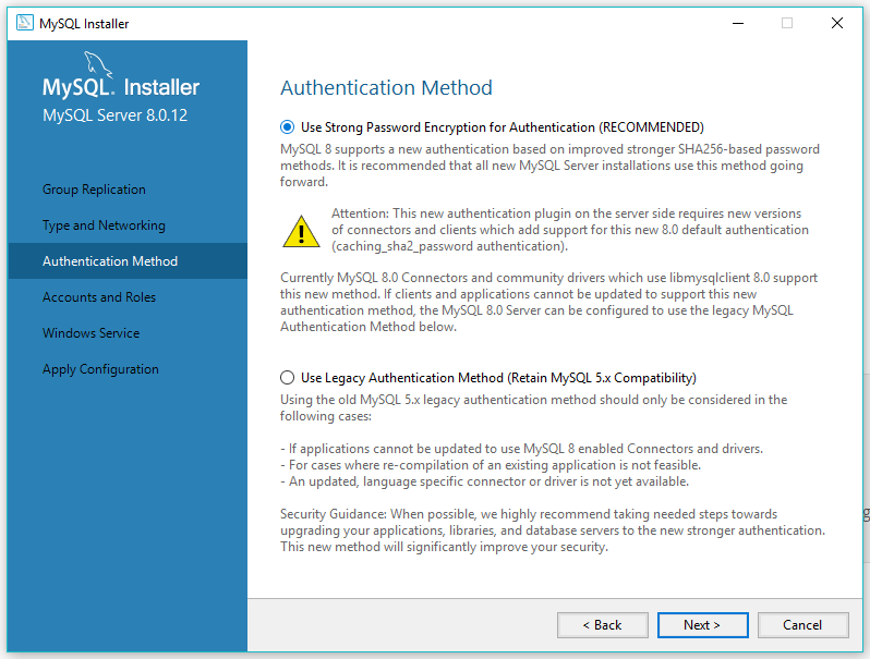

Unless you have specific requirements do not change the settings on this screen, click Next

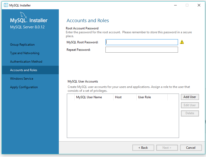

Create a strong and secure MySQL root password

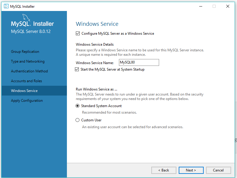

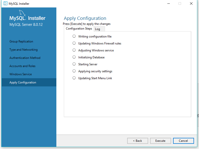

Click Execute
The installation will complete, on the following screens click Next, then click Finish

Enable TCP/IP Networking — This is the default. Keep the TCP port that MySQL uses to listen at 3306. If the database will be running on a separate system from the Web server, select the Add firewall exception for this port check box.
