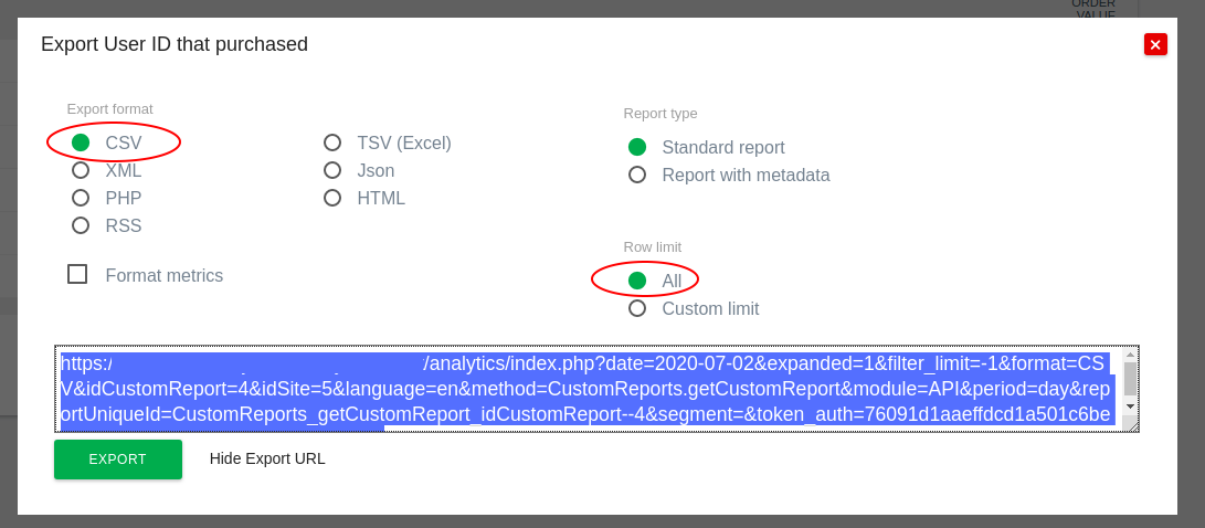

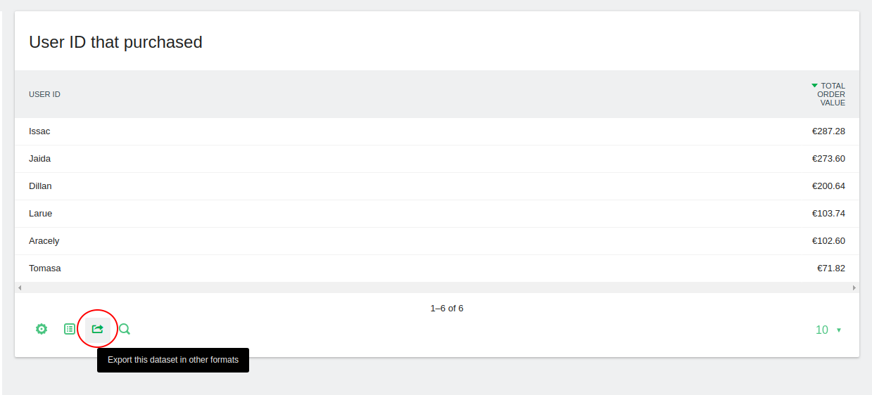

1. Click on the Export icon.
2. Choose CSV under Export Format, choose All under Row Limit, click Show Export URL and then copy the Export URL.

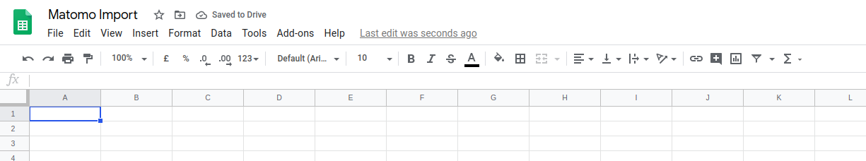

3. Open a blank Google Sheet and name it appropriately.

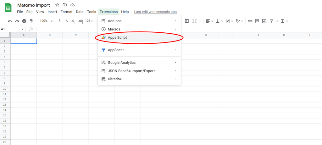

4. Click on Extensions > Apps Script.
5. In the Script Editor, paste the code find below. The code supplied is not supported nor created by Matomo as this is just an example of how to achieve the connection.

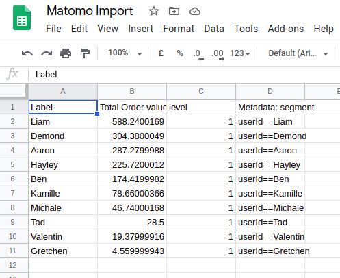

10. Data should be imported in the Google Sheets at this instance. You would need to run this manually each time to have data imported into Looker Studio.

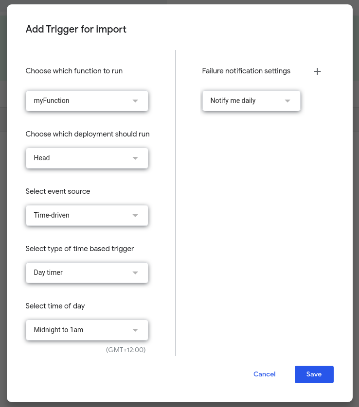

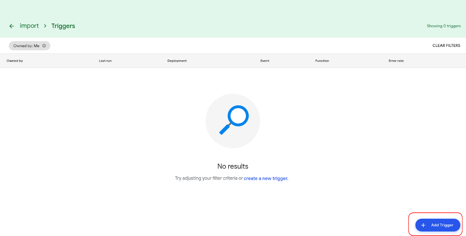

1. Hover over the clock icon on the left. Click on Triggers.
2. Click Add Trigger.
3. Choose the frequency to run the import.
4. Save the Trigger.

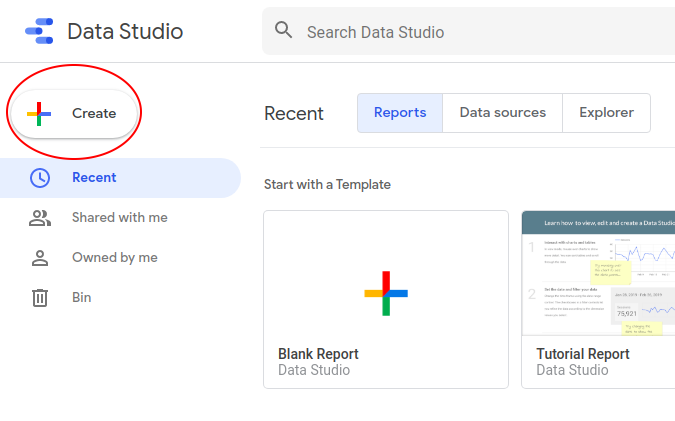

1. Open Looker Studio.

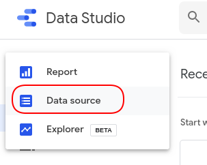

2. Click on Create.
3. Choose Data source.

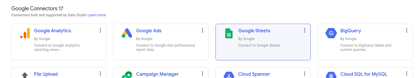

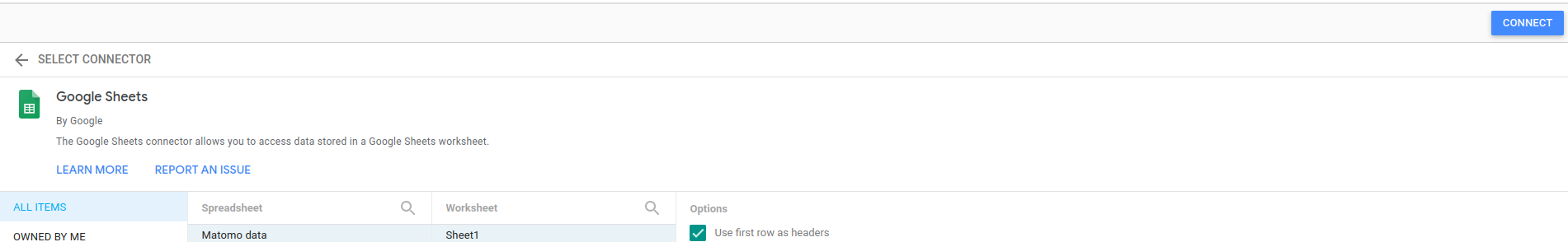

4. Click Google Sheets, you may need to authorise Looker Studio to gain access.
5. Select the spreadsheet created earlier (see section above) and leave the default options selected and click on Connect.

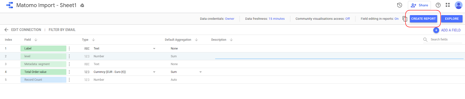

6. For each field, check that the correct data type is selected or update it appropriately.
7. Click Create Report.

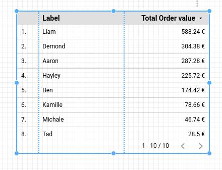

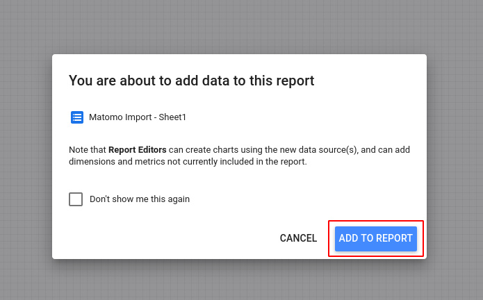

8. Click on Add to report.
9. You should now see the report with the data added.
