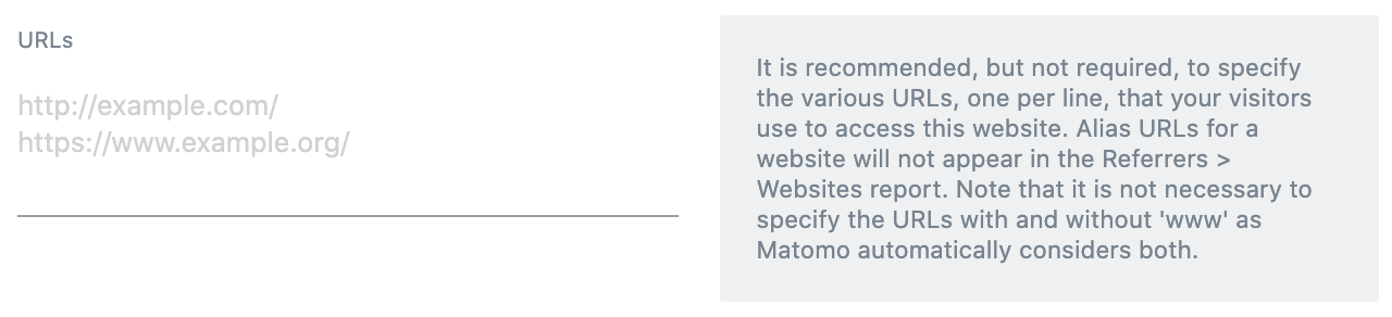

- Complete the necessary details about the website, such as the name and URL. You will find a short description of what each field should contain in a grey box next to it.

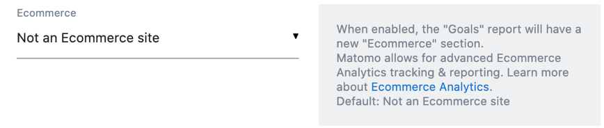

- Several fields down you will reach the Ecommerce settings. By default, new websites are set as Not an Ecommerce site so you will have to click on this dropdown to select Ecommerce enabled.
- In the following field, select the primary Currency that you operate in. This will impact both your Ecommerce and Goals reports.

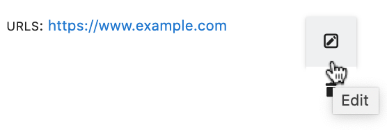

> Websites. - Find the website you’d like to update and click the Edit icon.

- Scroll down the page until you reach the E commerce dropdown menu, and select Ecommerce enabled.
- Select the appropriate Currency option in the dropdown that follows.
