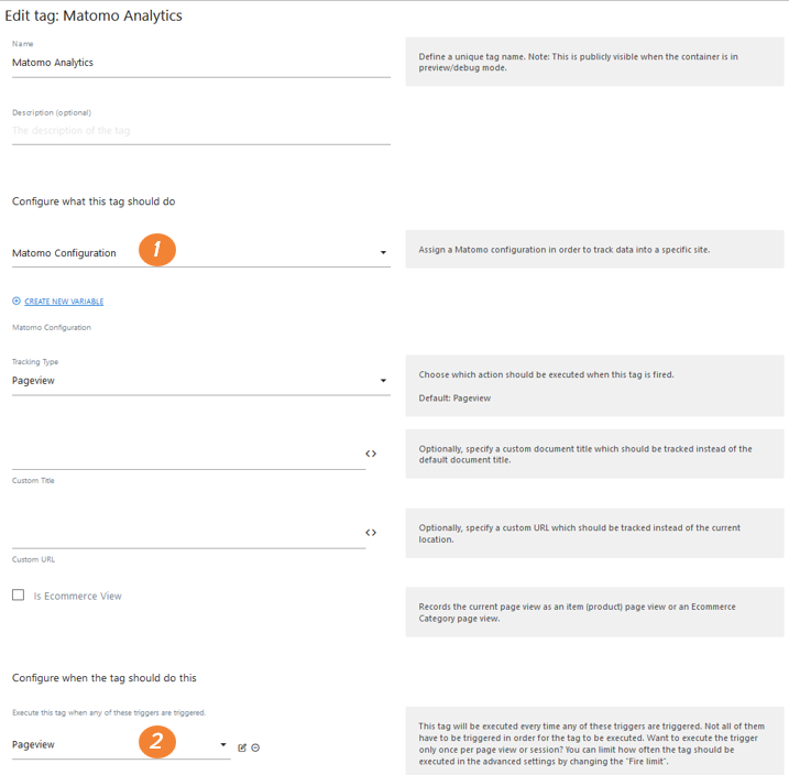

Go to Tags and check the predefined Matomo Analytics tag is added with the Matomo Configuration variable (1) and Pageview trigger (2) selected.

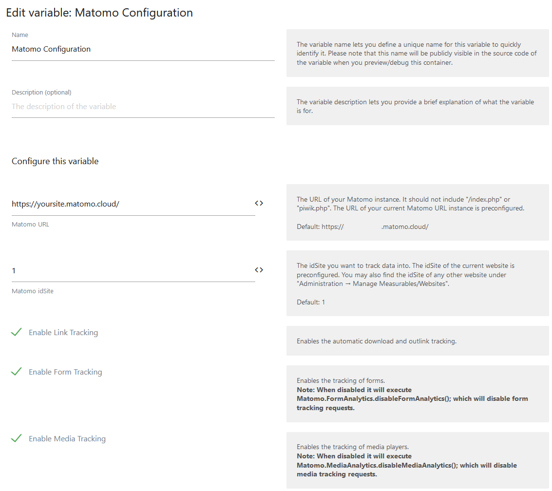

Go to Variables and open the Matomo Configuration variable. The Matomo URL and ID Site must reflect the correct website you are tracking.
Note: The options for Enable Link Tracking, Form Tracking, and Media Tracking are selected by default. Ensure the selected tracking options align with your tracking needs and privacy policies.

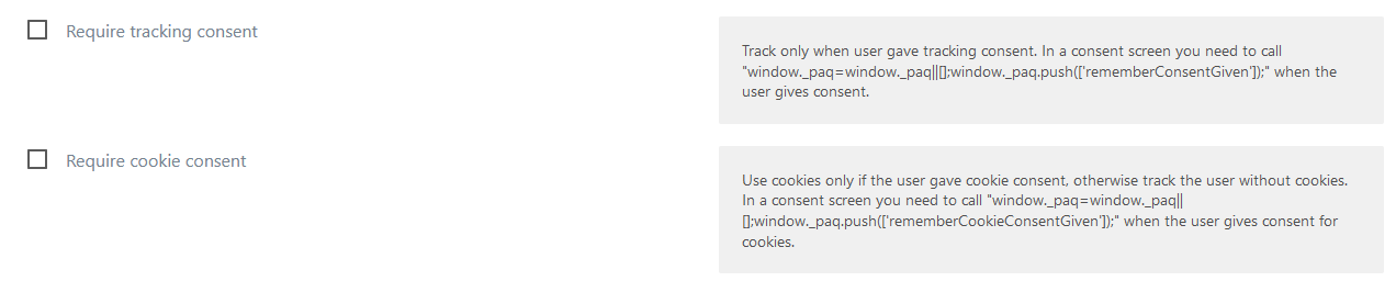

To ask for consent to track with cookies, enable the option, Require Cookie Consent. When selected, Matomo tracks visitors with cookies but only after they give consent. If your website visitor does not give consent, Matomo will continue to track but without cookies. Learn more about how cookies impact report accuracy.
To ask for consent to track, enable the option, Require Tracking Consent. No tracking occurs unless explicit consent is given. This is stricter than cookie consent alone and applies to both cookie-based and cookie-less tracking. If you select this option, you will need to use a specific Matomo script in your Tag Manager setup. The instructions for this consent method are provided in the relevant CMP guide.
