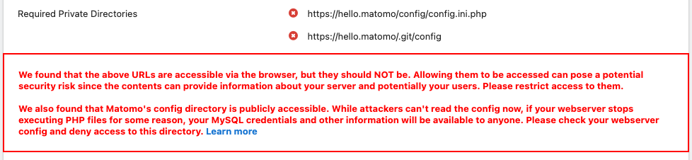

In the Matomo System Report you may see an error that says “Required Private Directories” and looks like this:
This means the content for these files are accessible by anyone by entering the mentioned URL into the browser. Some of these URLs may include private information such as the credentials (username and password) to your database.
