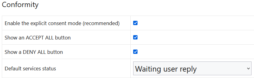

- If using Method 1 or 3 (described below), ensure the Tarte au citron Conformity settings are configured. Click the three vertical dot menu and select Options > Conformity settings:
- Enable the explicit consent mode (recommended).
- Default services status: set to Waiting user reply.

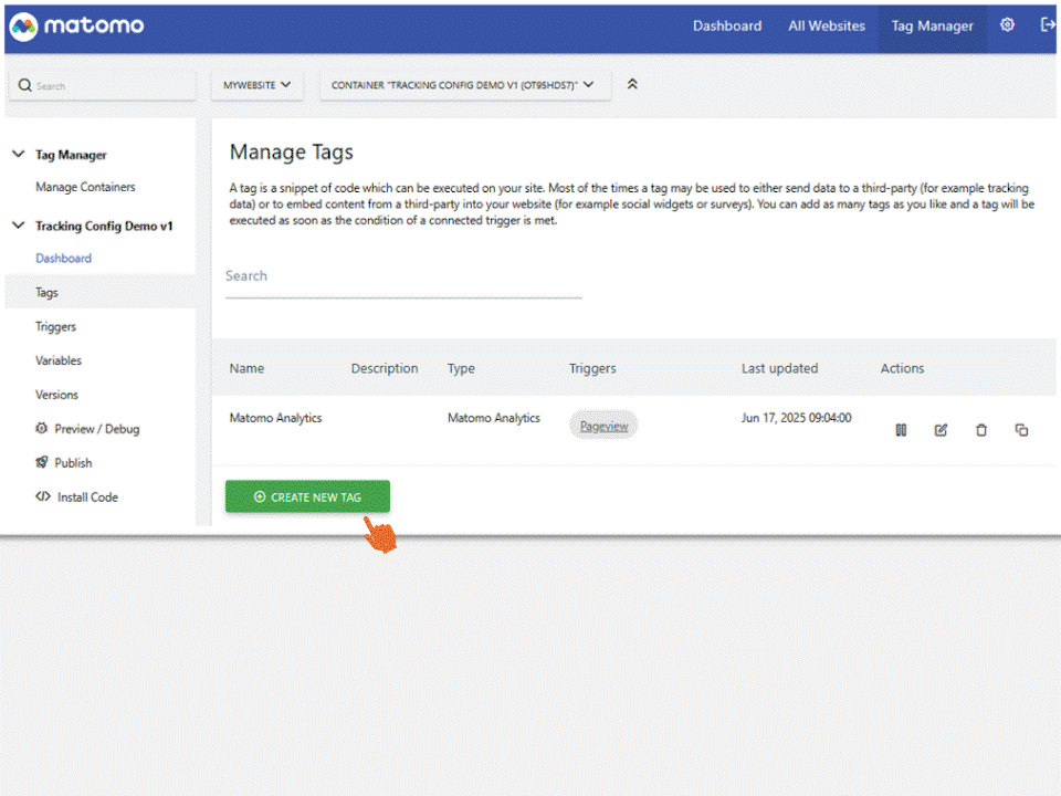

- In Matomo, navigate to Tag Manager > Tags and click Create New Tag.
- Choose the Custom HTML tag and provide a user-friendly name (optional).
- In the Custom HTML field, paste the initialisation script (copied in step 1).
- Set the Position to Head Start.
- In the section, Configure when the tag should do this, select a Pageview trigger.
- Scroll down to the consent options and enable Require tracking consent. If you do not see this option, confirm if Disable cookies or Require cookie consent is selected. If one consent option is enabled, the other two settings are hidden.
- Click Update to save the changes.
